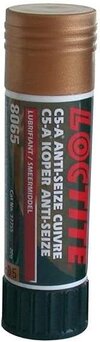

Is the copper anti-seize similar (except chemically) to that evil, demon-possessed silver crap?
It makes removing fasteners much less stressful (is this rusted in place?), it simply gets on EVERYthing within 4 feet. I'm super careful about touching things, but when I go to collect all my tools to put them away, every single one has a smear of anti-seize somewhere on it!
The benefit of copper slip: it ain't alive... ;)
Hence it won't suddenly appear anywhere...
Loctite 8065 C5-A is brilliant, like a Blistex, dip the end of a bolt in, install... remove with ease and no damage a couple of years later...
And I spray the exhaust clamps, bolts and joints with copper spray during any occasion the rear wheel is removed...
Weird smell on the next red light though... ;)
