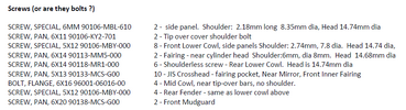

Apropos of ST 1300s with wind deflectors on the sides (including the little part over the maintenance panel), @970mike wrote a really good article about how to avoid losing both the maintenance cover and the wind deflector that fits over it - here is the link: ST1300 - Fairing Deflector Inspection Cover fixI'm not sure why Honda chose to use a longer push rivet for the maintenance panel on bike equipped with the optional wind deflectors. The standard push pin rivet 90116-MCS-G00 is an exact fit even with the deflectors installed.
I am sufficiently concerned about the rather tenuous attachment of the maintenance cover and associated small wind deflector over top of it that I use a large pan-head screw driven into a rawl plug (plastic expansion plug) on the underside, rather than the Honda fastener. I never bother taking the maintenance covers off - if I have to do work in there, I take the whole side fairing off.
