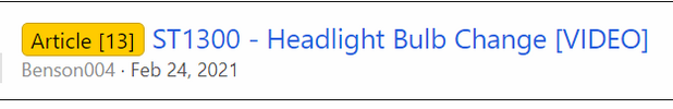

Article [13] ST1300 - Headlight Bulb Change [VIDEO]

Perhaps you miss my point, an "Article" on this forum simply tags the post so that it's easier to find. I wasn't proposing that the content be changed, simply the "Article [13]" tag added.
Which Mellow then did.
