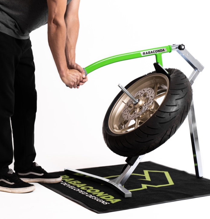

Using the Rabaconda Street Tire Changer to change a Dunlop Roadsport 2 on a cast-aluminum wheel from a Suzuki GSX-8TT. (Photo by the author)

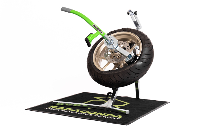

The keys to the Rabaconda Street Bike Tire Changer’s effectiveness are numerous, but chief among them are its smart design features. It provides a sturdy stand for the wheel and tire well above ground level that allows you to break the bead and spin the wheel easily. Instead of struggling with tire irons that can mar rims and pinch tubes to pry the tire off, the Street changer’s non-scratch duck head ratchet system slides around the tire bead and rim like a powered pneumatic tire changer, smoothly lifting the tire off or pushing it onto the wheel. Unlike other “portable” changers that need to be mounted to a platform or trailer hitch, the Street Bike Changer stands solidly on its own and breaks down and packs into a roomy 29x11x10-inch reinforced bag, which weighs 37 lb loaded with everything. It stores readily when not in use and is easy to transport to events – or the homes of all your new friends.

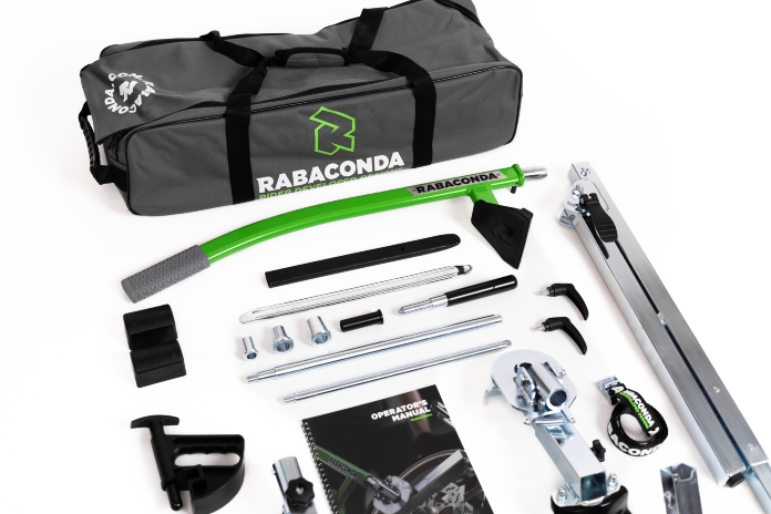

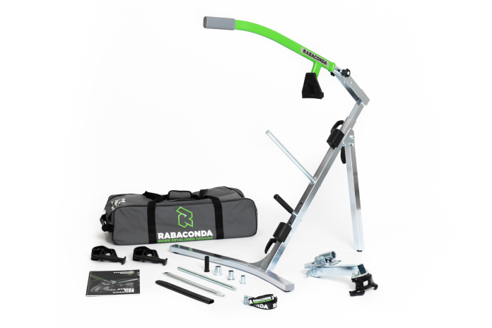

The Street changer sets up in seconds. The main components are a steel four-piece main stand assembly, bead breaker handle, and duck head ratchet system. The basic kit also includes both 15mm and 20mm steel center spindles (axles) that fit most wheels with 15-32mm hubs, a pair of drop center tools, a 16-inch tire iron with protective cover, wheel stopper post and strap, magnetic wheel supports with separate riser brackets (for wider hubs), and a nice wire-bound, full-color instruction manual.

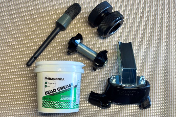

For a few bucks more, the Ultimate kit that Rabaconda sent us adds a special duck head for cross-spoke tubeless wheels (which have spoke heads on the outside rim edge), universal big hub and BMW shaft-drive hub adapters for 33-68mm hubs, bead grease, and a brush. Everything conveniently fits in the travel bag. I highly recommend adding the grease and brush ($25), even if you don’t need the rest of the Ultimate accessories – the extra slick, non-toxic, and biodegradable bead grease makes installing a stiff tire much easier and safer.
The optional Ultimate kit. (Photo by the author)

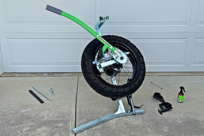

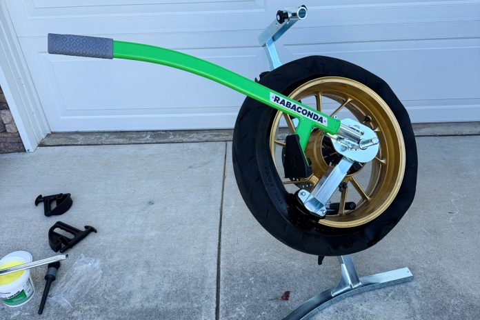

Using the Rabaconda Street Tire Changer to change a Dunlop TrailMax Mission a spoked rim. (Photo by the author)

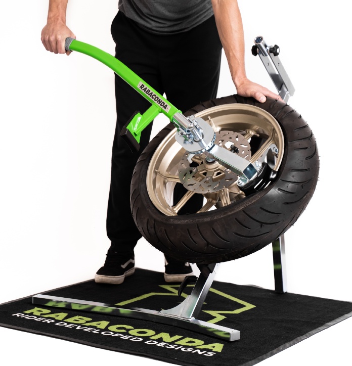

The process goes like this: You slide the wheel over the appropriate center spindle, adjust the positions of the non-marring wheel supports underneath, and slide one of the included stepped bushings over the spindle and into the wheel hub if needed to minimize free play. Brake rotors do not need to be removed. Adjust the position of the bead breaker on the tire and push down on its handle to break the bead, then flip the wheel over and do the same on the other side. Now the duck head system goes over the spindle and onto the rim, and (while pushing the tire down on the opposite side with the bead breaker) the tire bead is lifted over the duck with the single tire iron, which hooks into the ratchet. The wheel is kept from spinning with the stopper tool or strap (on spoked wheels), and the bead gets lubed up with grease or soapy water. Remove the bead breaker handle from its socket above with a simple 90-degree turn and insert it into the duck head ratchet, then begin levering the duck head around the rim. The ratchet system lets you make short swings down with the handle, raise it, and repeat, like pumping a well, so you can stand in one position behind the changer.
Breaking the bead.
When the first bead is off, you can perform a flat repair if needed and then reverse the process to reinstall. Use bead grease on the bead and duck head when installing. Or to fully dismount the tire, poke the tire iron through to the other bead, lever it over the duck head, and ratchet away.
The usual rules apply. Warming the tire first will make it much easier. Keep the bead in the drop center of the rim opposite where you’re mounting or dismounting, with the drop center tools and/or bead breaker as needed. Use plenty of lube, and if the tire has a marked light spot on the sidewall, orient it beneath the valve stem. If the tire is directional, make sure the arrow is pointing the right way.

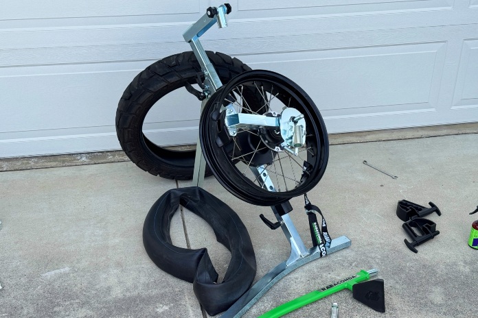

A little extra care is required when using the Rabaconda Street Tire Changer on tires equipped with tubes. (Photo by the author)
I tried out the Street Bike Changer on a Dunlop Roadsport2-X 180/55-ZR17 mounted on the cast back wheel from a new Suzuki GSX-8TT. It was so easy the tubeless tire practically jumped off the rim on its own. Same with putting it back on – I almost did it again just for fun. There’s just no comparison to the sweaty agony of using tire irons, rim shields, and bead holders on the ground or a five-gallon bucket, and that’s after you break the bead somehow. Just remember to position the magnetic wheel supports so that they are only touching the wheel and not the tire, otherwise the wheel can rock on the spindle.
For a greater challenge, next I tackled the notoriously stiff Dunlop TrailMax Mission 150/70-18 tire and tube on the back of my Africa Twin. Though it certainly required more effort, it really wasn’t much different or more difficult than changing a tubeless tire. I learned to leave a little air in the tube to give it form when mounting and dismounting, or it can get caught under the duck head. After the first bead is off, remove the valve stem from its hole as usual, but with the Street Bike Tire Changer you leave the tube in the tire until it’s completely dismounted. The manual doesn’t cover how to deal with tubes, but this info is easily found online. The magnets that hold the wheel supports to the main upright are really, really strong. It’s easier to tap them up or down with a plastic mallet than to remove and reposition them by hand.
