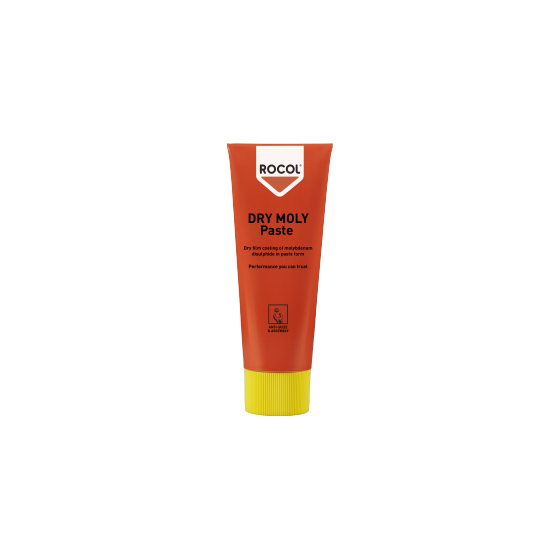

Rocol dry moly paste part number 10040. Igofar approved 'cuz it was listed in the Factory Service Manual as an authorized sub (I'm sure I read that somewhere...;). Note, that you can buy from Bike-Quip out of the UK for cheaper than the USA source. Bike-Quip buys the big can and then weighs out 100g and passes the savings on to you. :thumb: Or you can buy from Starlight. I did both 'cuz, well it's MOLY!!! :eek: And you can't be too safe! :rofl1:

Both of these products will meet you requirements. Not the cheapest, but a good product designed for splines.
Rocol Dry Moly Paste 10040 100g tube $50 each plus shipping, new batch manufactured in September 2019, 4 year Shelf Life.....email me Alain@StarlightMaintenance.com or checkout online at our store.
We are a Rocol distributor here in the USA and would like to offer you special pricing, I have setup a discount code for all of you on ST-Owners forum!
Here are is a screen shot of the discount code for all of you to use to get the Dry Moly 100g tube for $50:
I used the ST-OWNER discount code and got a tube for $50, was delivered in two days. Very happy with the support and service from Starlight Maintenance

Would you care to share the actual Moly content as I can't find that data anywhere?

What good is a 4 year shelf life? My Honda Moly Paste in the 1" diameter by about 5" long tube is 7 years old already, and will probably last me until i die. Plenty of guys here have tubes of this stuff that are pushing 20 years or more. FOUR YEARS? Sounds to me like a ploy like Hostess Twinkies or Coke saying eat/drink within one year....

On a good note - there is 77% Moly, hence the name, if that is what you consider a good product based on Moly content (Same as Moly 60 before it was discontinued). I know Rocol focuses on a blend of tenacious mixture to adhere to the surfaces until dry, has a resistance to pick up contaminates and has a good high temp range. The shelf life is actually 5 years for this product...what we have currently on the shelf is 4.5 years of shelf life left, technically.
Shelf life has a lot to do with the additives and water content. To ensure the purest form of the product standard, they establish a shelf life for the consumer - Potential deposits of mold, mildew, ect. start to form after some time. Breakdown/degradation of additives lose effectiveness over time. I'm sure it is still good to use and will get the job done...
