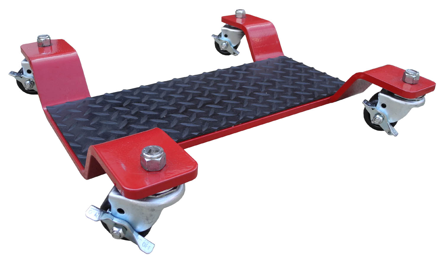

Looking for advice on these centre stand types of motorcycle dolly's...anyone have any experience with this simple looking dolly? Kind of expensive at $175 - $199. Anything less expensive?

$199 seems outrageous for that center stand dolly. I could easily build something for a hell of a lot less. I think the one from Harbor Freight would be a lot more stable than trying to roll a 700 lb bike around on just some casters under the center stand.

I have the Park N Move. Works great for me on a smooth cement floor and allows me to pack my bike in the corner, ride it into the garage and spin it around so I can just ride it out. Very stable on the center stand. They tell you not to work on it while it's on the dolly but you know we never follow directions. There is a video on youtube that shows you how to get it up and then back off the dolly, this is a must watch.

Yes, I really like the Park N Move type of dolly. Can't justify the $199 + shipping + customs duty (Canada). While the castors are only about $28, it's finding the correct gauge and shape of the metal thats the problem.

$11.00 CDN lazy susan swivel plate at Home Depot, mount a thin piece of any old scrap steel to it as a platform and your good to go- the span between the centre stand legs is so small you don't need any special high strength steel. I know it is only rated for 1, 000 LBS. but I made one and it works just fine. It may not have the longevity of the pricey true motorcycle dollies but for that price you can buy a new one every five years.
