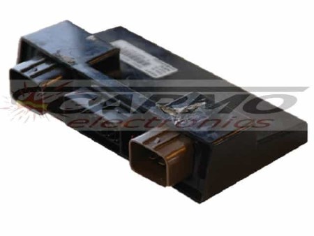

During my looking to see how available a spare used ecu was ( NOT!) I came across this site claiming to be able to repair the ecu
On their site they claim to be able to also fix the Throttle Control sensor and the ABS computer.
And I knew about this site from before but strangely they have an ST in their list but they didn't come up in the search
Be very careful of those sites. Assuming they know what they're doing with any ECU, there's a strong chance they'll brick an ECU if they're not familiar with the ST ECU. Most sites like this tend to have done it once before, and they got lucky. With the number of people wanting different fuel maps for supposed throttle issues on STs, companies that will do fuel maps are still pretty rare - and that has nothing to do with the age of the bikes. I honestly wouldn't waste my money unless they were willing to put you in direct contact, on the phone, with someone that has used their services and still rides the ST they modified.
Fun fact too, I was trying to figure out how to tweak the ECU on my Jaguar many moons ago, so I put an industry standard tool into diagnostic mode, seeing if it could just do a raw dump of the CAN traffic for me to analyse later. This was a 2005 car. About 10minutes into my journey, the LCD on my dash lit up "TAMPER DETECTED. SHUTDOWN IN PROGRESS." - and the whole electrical system went dead. At 70mph, I lost power steering, ABS, ignition, radio, everything. If my 2005 car had that, what's the chances of Honda putting tamper detection into ECUs?
Can the ECU be tampered with? Probably. In my line of work I like to think that nothing is impossible. But, everything comes with a cost in some shape. I'm actually interested some day to compare a police ST ECU with a civilian one, mostly for the sake of curiosity - but assuming there's some tamper detection baked in, I'd probably burn through 6 of each type before I knew the differences. I'm not sure as a group, we have 12 spare ECUs for me to play with, just for a curiosity.
Then there comes the supply & demand aspect to it... if we're talking about learning how to fix FI fault codes, and lets imagine I did figure that out. I'm looking at less than 50 sales over 20 years. That makes my unit cost so high that it's just cheaper to pay the price for a new/used functional ECU. It'd also have to take it's own priority in my "pet projects" queue, unless someone is going to pay me enough to figure this out that I can quit the day job.
Even if ECU's turn into unobtainium like the wind deflector kits, it's sad to say, but you're insane if you want to pay me to dig into ECUs rather than just buy another bike.
